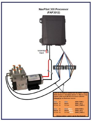

I performed the dockside tests at the dock with the motors running. I got the same result, I failed the safe helm sensor test. Next I did the sea trial and everything went well. I did have issues with the TZT14 communicating with the Navpilot, but I think need to change PGN outputs for Navigation Data and Navigation - Route/WP correct? Checked that after I was back on the trailer.
If the FSP8 LEDs are functioning correctly, but I am not getting signal, what should I try next? I looked at each connection/wire in the wago connector and they "looked" ok, but I am not sure if there is a good way to test them. What is the signal, can I test that somehow?
