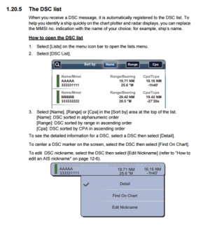

I just received my FM4800 VHF that I will be putting on my NMEA2000 network. I am running a TZT9 and Timezero 3.3 pro.
I am hoping that the Emergency DSC calls get plotted on the map if the sender has their radio properly set up. Is this the expected behavior? Will the chart recenter on the alert, or will I need to zoom out to find it? I assume I can acknowledge the alarm and hopefully have a menu selection of navigate to?
I know that I would need TZT2 if I want to make radio calls to AIS/DSC targets, but I am ok with not having that feature, what I want to understand emergency DSC calls.
Thanks!
Howard
