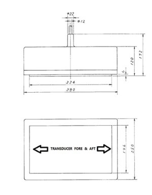

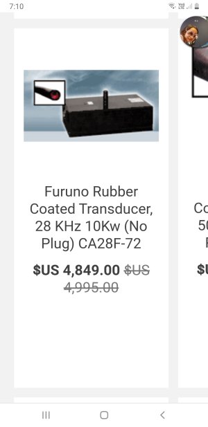

Sorry for stupid question but is ca28f directional or is is same front and rear i can't see any marking in it as to foward direction?Yes, the FCV1500 manual shows the BT-5 as an optional item on page iii. Although it supports it, that sounder is also a very old unit (20-25 years old) so the capacitors and components might not be up to the task.
When using the CA28F-72 transducer the tap setting inside the BT-5 would need to be setup for "C".
