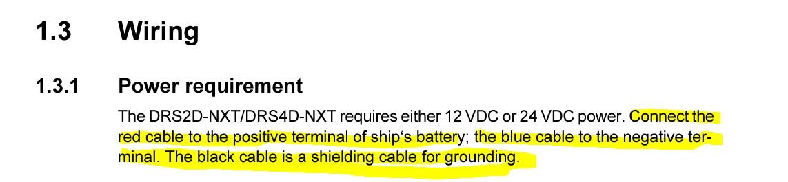

R rodneymeyers Furuno Fan Jul 1, 2022 #1 I just got the DRS4D NXT dome. It has a red, black, and blue wire. I take it red is hot, black is ground, what is the blue for?
