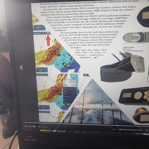

C Cyclone New member Oct 24, 2025 #1 Good day all I battle to set my machine to show me the format in bathy to be 3d I've attached a picture in my attachment please help Attachments Tz 10.jpg 176.5 KB · Views: 12

Johnny Electron Administrator Staff member Oct 24, 2025 #2 Are you asking how to purchase the TZ Maps charts for your area or are you asking how to conduct 3D bathy data with the DFF3D multibeam sonar?

C Cyclone New member Oct 26, 2025 #3 How to conduct 3D bathy data with the DFF3D multibeam sonar please and thank you

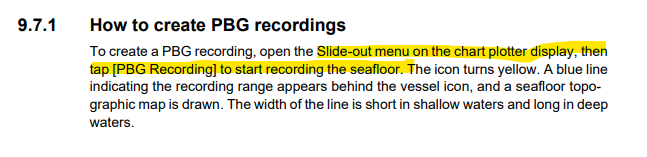

Johnny Electron Administrator Staff member Oct 27, 2025 #4 When you swipe from the left side of the screen inwards from the plotter screen you should be offered the "PBG Recording" option. If you have the items installed it should be available there.
