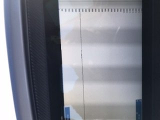

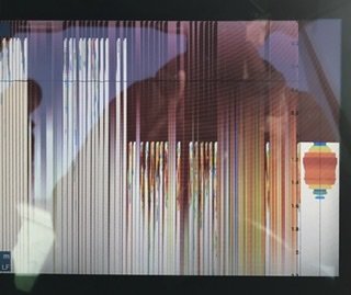

Thanks for the info, I will try that next time I’m out. I will post pics of a messy screen that appeared while idling at 429m which was replaced after a few seconds with the blank white screen. Another pic is from 25m which is much better.

Yes, some better pictures for SNIPS would be great. That last one seems to reflect a ton of RF noise being picked up by the sounder.
