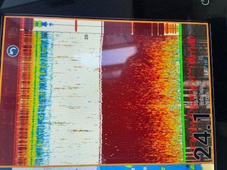

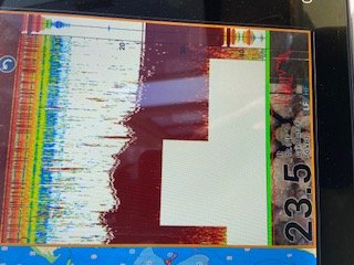

IMG_2866.jpgIMG_2865.jpgView attachment 1I have a new TZTouch 3 16. It is hooked up to a 525T-LTD transducer that is also new. I think when they bottom painted the boat they painted over the transducer. It has not been right since first trying it. Maybe I got a bad new transducer. Can anyone please help me on this. A few pictures.

It appears that there is lots excess "noise" on the sounder screen. So I'd give this a try this first:
1. Go to the Fish Finder Screen
2. Swipe up from the bottom
3. Find the Fish Finder Settings
4. Then Set Hardware to Factory Default
Also, be sure that you are NOT selecting both ACCU-FISH and Bottom Discrimination ON at the same time, as this can mess with the Fish Finder Settings, resulting in poor echoes.
- Deep Blue ;)
