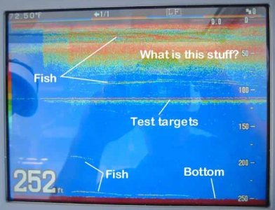

Playin Catch,
This clutter is pretty common on the east coast. Below is a screen shot from years ago of a FCV-1100 using a B-260. This gentlemen was trying to determine what that layer was i.e. plankton, small bait, thermocline as he was having a hard time detecting fish below it. I had him rig up some targets just for a quick test.
So using your settings you are probably seeing a very similar display. Using a TVG setting of 9, max's out the TZT2's shallow water gain, default setting is 5. The Auto Fishing mode adjusts the Gain, Clutter and TVG controls. If you go into the Sounder menu when you are in a Auto mode you will find that the Clutter and TVG controls are grayed out (no access).
Normally when you turn on the Auto Fishing Mode you will find it will clean up the display, but sometimes it can take away to much. If you find it takes too many targets off the display you can readjust the Auto Gain setting. This setting presets the gain for the AF mode. You will find this setting in the Sounder Menu near the bottom of the page. There will be two settings, one for the high frequency (200Khz) and another for low (50Khz).

Ok thank you Snips i will lower my TVG down a good bit and will see what happens.... i prefer to fish in a Manual mode over AF or AC. but i also want to be able to see what is below me especially in the area that most of my target fish are hanging.
