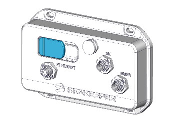

I installed a Seakeeper Ride in my Regulator 34 this offseason. I followed all of the instructions from Furuno and Seakeeper. I installed the app and updated all of the MFDs with the latest software.

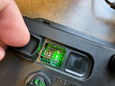

However, the MFD is not provisioning an IP address to the device. All of the settings on the hardware are correct.
I have tried to connect it via my HUB101 *and* a direct connection to the master MFD. Still, no IP address.
