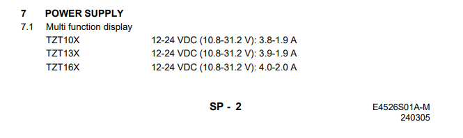

Johnny Electron Administrator Staff member Oct 2, 2024 #3 Online manuals list the power usage on page S-2. Furuno uses worst case not nominal values.

arisatx New member Oct 2, 2024 #5 Johnny Electron said: Online manuals list the power usage on page S-2. Furuno uses worst case not nominal values. View attachment 5723 Click to expand... Awesome - thanks Johnny
