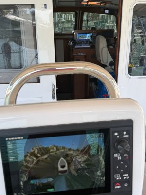

I have the TZT XL 16 inside the pilothouse - it is interfaced to the Avikus Dock II 360 deg view camera system which relies on the 16's HDMI and USB3.0 for mouse control. I also have a TZT XL 10 outside in the cockpit. While I know I can't control the Avikus display due to lack of USB3.0 port on the 10, would I be able to mirror the screen from the 16 to the 10? I know I can WiFi cast to an iDevice, but looking to do it right on the TZT XL 10. Thanks in advance for any ideas.

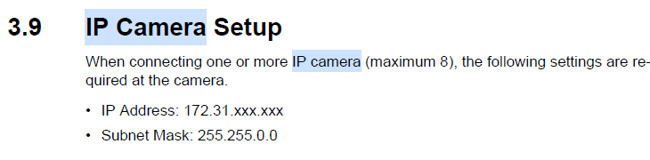

For IP video: A HDMI to IP video converter that can be configured per below or the one FurunoUSA offers is the VI-HDMI.
