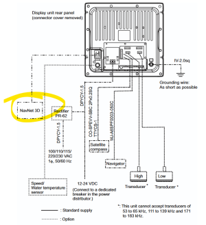

The FCV1150 says it can be networked to NavNet 3D (yeah, the manual is rather dated) Will the TZT XL platform support this? I have an old school, "I need knobs", kind of commercial fisherman that wants to also see the FCV1150 from another location 20% of the boat use time. I assume the TZT XL would run it like a DFF3UHD? I'm thinking of the FCV1150 at the main (he still likes a computer for charting) but give him a TZT13 on the tower? Nothing purchased yet, and it will be hard to get him up to speed technology-wise with the TZT XLs. Is this a crazy idea? Most likely he is going with a single CA88-B10 @2kW. He knows very well how to work that transducer.
