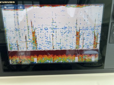

Tz3 bottom machine
Chevz7176,
For the picture that you have provided, it would appear that there is noise from any mechanical source that could be from a pump, bearing, or shaft. Or it can be from an electrical source, like a generator, electrical motor, or some electrical interference.
Does this also happen on the low frequency side as well..? :think
