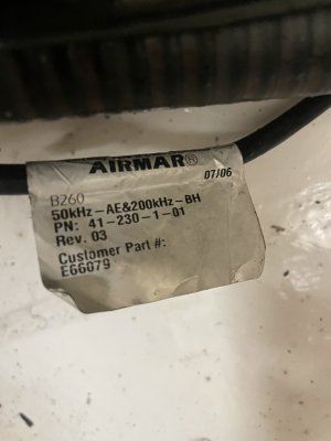

This is what I'd like to replace during our haul out, notice the date 2006
