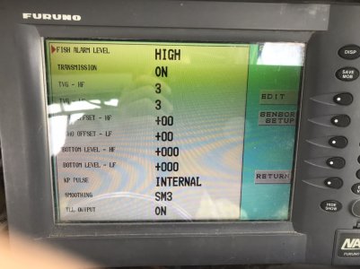

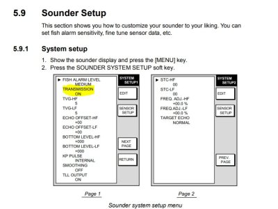

MENU - SYSTEM CONFIG - SYSTEM SETUP - NETWORK SOUNDER SETUP - Look for Transmission ON/OFF. Ensure it is "ON".Soundersetup.JPG
