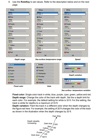

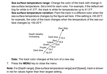

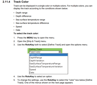

You can set up the temperature color in the NN3D as follows:
