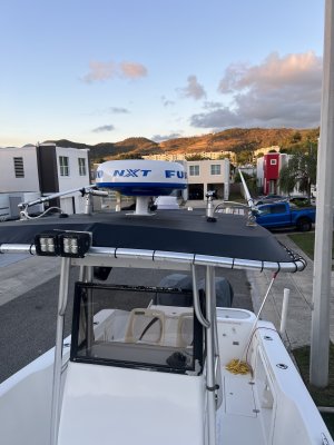

F frankiepr Member Jun 8, 2021 #1 Greetings, I am attaching some photos for your recommendations on where I am thinking to locate the SCX-20 and whether or not I should locate it there. Attachments STBD side Ttop2.JPG 916.4 KB · Views: 763
Johnny Electron Administrator Staff member Jun 9, 2021 #3 If either of those whips are live, it is a problem. You don't want VHF or AIS transmission whips that close. Normally you want about 3 ft minimum.

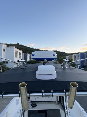

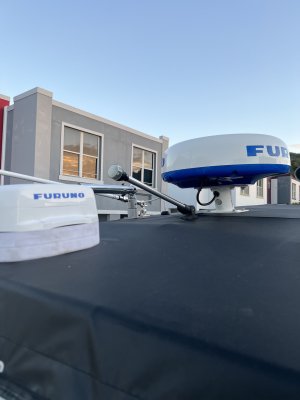

F frankiepr Member Jan 15, 2022 #4 This was the final installation. Vhf antennas are 4 ft 3 inches away for the gps. The Radar has a blanking zone starting angle at 173 to 187 degrees. Attachments IMG_0061.JPG 355.6 KB · Views: 328 IMG_0059.JPG 509.5 KB · Views: 330
Johnny Electron Administrator Staff member Jan 16, 2022 #5 With the blanking sector, that looks like a great location.
