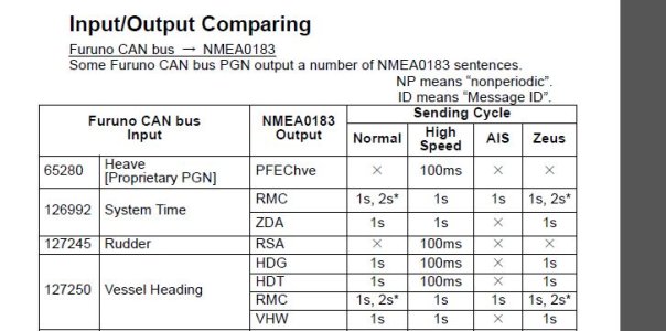

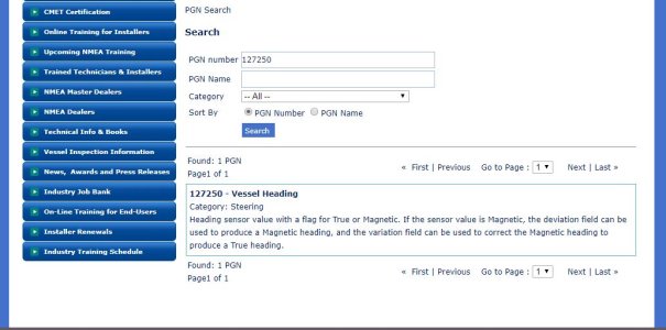

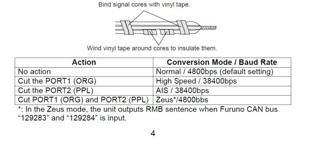

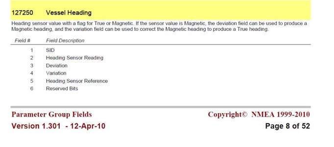

I hope to use the IF-NMEA2K2 with the SC33 to output NMEA0183 to an autopilot. I have a question: The PGN 127250 is listed for heading output from the SC33 at 100ms. What exactly is in this PGN? Is it HDT or HDM ....? Next question, the documentation for the IF-NMEA2K2 says output at 4800 baud is at 1s intervals. This is not fast enough for an autopilot. What options do i have for a converter?
