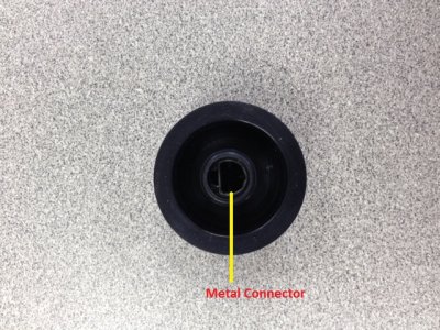

Sorry to hear about this. I am not sure why this happened to your Rotokey knob. If you pull it off, do you see the metal insert inside the knob (see attached picture). I am assuming that it might be missing and that is likely why you can't get the knob to stay on. Either way, let me know. I have a new knob with the insert sitting on my desk I'll send out to you. Just PM me your address. I'll look into the power button and see what I can find out about that as well. Thanks for bringing this to our attention.

Thanks Stickman,
After reading your reply I checked the shaft and sure enough found the metal insert sunk deep onto it. After prying it out and reseating it into the rotoknob the thing went back like it should and all is well now :jump
