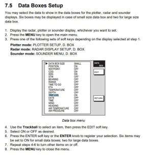

2) How do I create trip logs my Yammy gauges do a trip log but I would like to log my trip on my RD149's .
