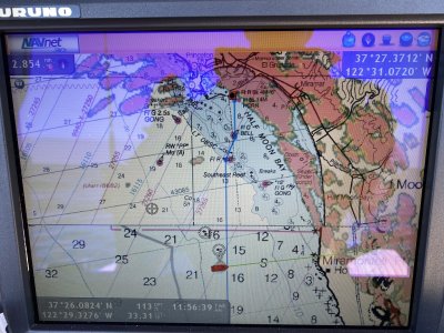

The radar overlay doesn't match up with the chart. How do I correct this?

Most likely it is related to your heading being incorrect. Drive a straight course and compare your steering compass, your GPS COG, and your heading. Do they all match within about two or three degrees. (Check going straight course all four compass directions)
