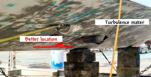

I have some pics I will post tomorrow, but as a guess the position wouldn't be much more than one foot from prop shaft.

Sorry not the best of pics but that tranducer is a B260 and where it is positioned at the moment gets air and turbulence if there is abit of slop and makes working in deep water difficult . I think the R309 will need to come further aft and closer to the center line to get cleaner water ? Your thoughts on this?.
Hopefully the worst of the turbulence created by the transducer will pass between the two props?.

Thank you for posting a picture of your current transducer location. Normally you will have better performance with the transducer mounted closer to the vessel's centerline. Also I can you see you have some sort of intake forward and lower in front of the transducers current location. Since the flow for turbulence is back and out you have the transducer mounted directly in that path. I advise avoiding these locations whenever possible.
