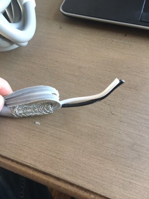

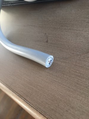

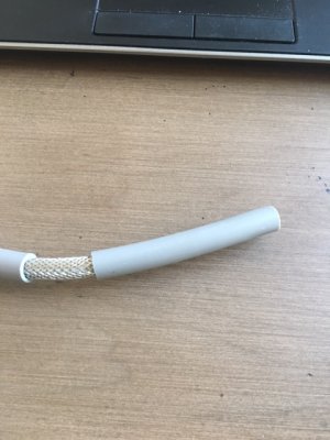

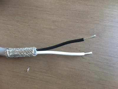

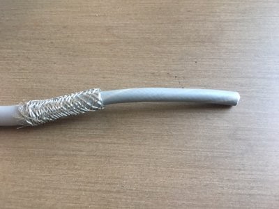

Good monring BReceski,
Thank you for your followup. Please see the photos below of a power cable similar to the one you have. Heat shrink and shrink to fit terminal connectors are always also a great way to insure proper termination into to your breaker panel. The grounding stud is used to connect the your TZT2 product to the vessels earth if you have one.
