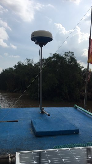

I have a 1724C Radar with 10m radar cable. My fishing boat is very small (the distance from the dome to the display is 3m only), so can I cut the cable to the 5m cable? If not what is the shortest cable length for my system?
Thank you
5 meters is the shortest allowed for analog radars like the 1724c. If you cut is any shorter, the radar timing will not be able to adjust and you will have problems with the proper display of the radar image.
