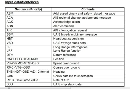

I used the AD10, I could not get the NMEA0183 to work when I tried.
It supposedly works with NMEA 0183, I tried and resorted to AD10. When looking at the manual, it sure looks like the HDG is supposed to be inputted using AD10
