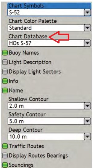

If they were vector charts you might need to go to the chart menu and select Jeppesen or Navionics under the vector tab. There is a selection for chart database and the default is HOs S-57. If you downloaded a Jeppesen or Navionics database they won't appear unless selected.
In addition make sure you have selcted vector (or raster) on the Roto-Key.
Beside just the Roto-Key where you choose the chart type (Vector - Raster - Fishing); you must ensure you have selected the correct data base for any VECTOR charts you wish to view.
HO S-57 = Hydrographic Office S-57 Vector
Jeppesen = C-Map by Jeppesen Vector
Navionics = Navionics Vector
-- You will find this setting under MENU - CHART icon - VECTOR Tab.
Chart Database: Select the chart database to use among [HOs S-57], [Jeppesen],
and [Navionics].
