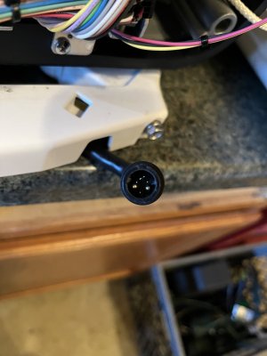

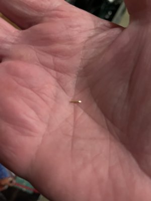

I live in central NJ , I bent some pins and snapped one off on my power wire to my radar . Other then Furuno is there a repair place that anyone knows of that can fix this In NJ.
It wasn't clear by the original poster what model was being displayed. It appears to be an open array.
If you have an 1815 radar (dome), you will find the interconnection on page S-1 of the manual. The pigtail cable from the internals of the 1815 radar to the connection hanging out would be part number 000-168-864-10.
