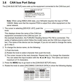

I would check your CAN BUS SETUP to make sure you see the TZT16F show up, and when you select a "GO TO" on the plotter these should PGNs light up on the NP711c control head when in this menu. If they don't light up, check your CAN BUS or NMEA2000 network for any issues, low power, improper termination, etc.
Ref. 3-20: https://furunousa.com/-/media/sites/fur ... manual.pdf
- Maggy

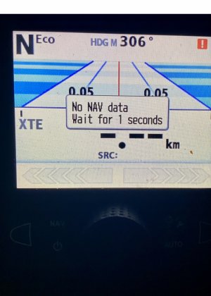

I think I am having the same problem as in this thread and i have spent a few hours trying to fix. My system consists of 2 Tzt3, 12 and 16 with a SCX 20, 330 and a PG700 and a 711OB. When I hit the waypoint on the screen I want to go to the autopilot engages but then i get what is in the photos attached. The autopilot won't navigate to the point. I had to install a new pump ( and just installed the SCX 20. Even if I engage my autopilot without the waypoint, it goes for a few feet and then makes a hard turn and wants to basically take the boat in circles. I have adjusted the instances so the SCX is 0 and the others 1,2 but still getting the same result. Any thoughts?
Sounds like you may have 2 different problems.
Did you try the advice offered earlier in this thread about turning on the PGN's to share across N2K? This could be your NAV issue.
Why your AP won't work with Auto mode - Perhaps try dock side setup again if the pump is different than what you replaced? I'd also do sea trial again as the settings would be based on the old pump.
There is a PGN that needs to be turned on from the display to feed the AP that information. I don't remember which ones and am currently out of the country. Will be back memorial day weekend to get that information if someone doesn't provide it prior to then.
