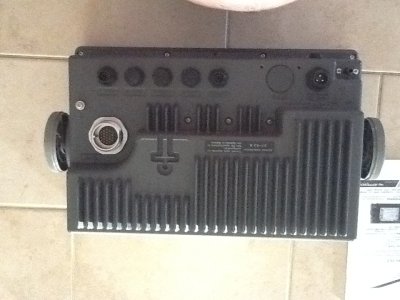

Unfortunately the sticker with the serial number is missing. Is there another way to find the serial number? If there is another way to determine serial number can Furuno send me a new sticker to place on the display? How do i determine what the program number of the machine is?

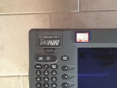

Attached two pictures
The front door where the chip goes says Navnet Vx2 c-map NT MAX
The chip says:
C-MAP Max C-Map NT
M-NA-M024.21. MWM
09-jun-2012
Usa west coast and hawaii

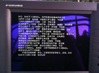

The chart door says it is C-map, but the software might not be or it could have old software. Please get the software program number. It will show up at the bottom of the chart disclaimer screen or during the self test of the unit. (MENU - SYSTEM CONFIG - SYSTEM SETUP - TEST & CLEAR - MEMORY I/O TEST - DISPLAY UNIT TEST)
Ok i got the software number and yes you are correct it has navionics gold software on the startup screen. Since i already own the c map chip i obviously want to stay with that. Can i convert from the navionics gold to c map? If possible does a dealer do this or can i do it myself?

Your programming is Navionics (1.09 which is very old) and not C-map. Since you have a C-map card, I would recommend working with your dealer; or open a support case (do it yourself), to convert the unit into being a C-map programmed unit. (V4.03)
If I wanted to send it back to Furuno to do this upgrade as well as place a new ID sticker on the back since mine is missing is that possible? If so do you know the address or the process to get this done?

Once a serial number plate has been removed it can't be replaced. These are installed at factory. The unit can be mailed to the service center at the following address:
Furuno USA
Attn: Service
4400 NW Pacific Rim Blvd.
Camas WA 98607
