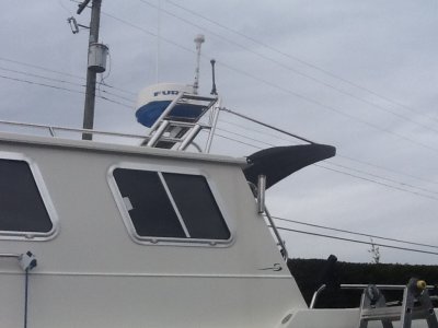

When gps is working, get a good fix, however returning today in overcast weather, suddenly lost gps fix, had worked excellent the previous 2 days. Just trying to get an opinion on antenna before buying new at cost of $400 US. Any help appreciated.
I would ensure that VHF is at least 3 feet away from that GPS or it will encounter RF damage over time. I don't see any other placement concerns.
