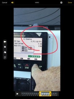

To verify the pump is not drawing power, I put it into bleed mode and check the amps when I try to move the out drive...when drawing it moves and when it stays at zero it does not move (makes sense just does not make sense why getting no juice).
When it goes off kilter, you can see it trying to steer With red or green arrows it just does not go anywhere and eventually I get the deviation alarm.
