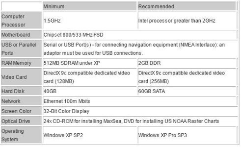

Here are the requirements. Most new PCs will exceed the specs. It is important that you have XP (SP2/SP3) operating system and it not be the server or media center editions. Recommend Nvidia video card with level 3 shading. (Most anything new does this).
ATI video is okay but might take some playing with; really really recommend Nvidia. You just need to ensure you can get the PC with XP and the XP drivers.
