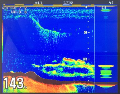

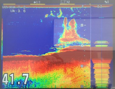

I think that the FCV-295 or 1150 using a CA50BL-12HR would give you what you are looking for. Below are a couple of screen shots of a FCV-1200 using the CA50BL-12HR.
Hope this helps.
