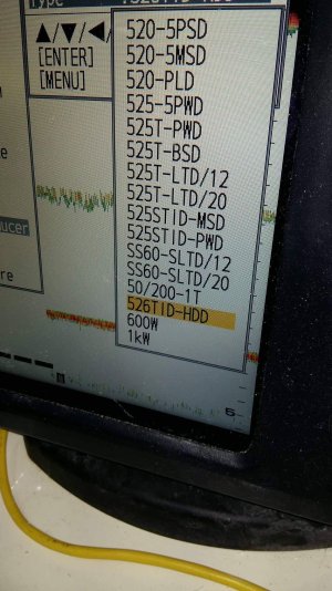

Hi,
Could someone tell me what I should set as a transducer type on my FCV 588 for my M260?
Thanks.
The Furuno part number for the M260 for the FCV588 is 527ID-IHD. It is not in the list, so you will choose the correct power setting (1Kw) at the bottom of the list.
for tm260 ? How do I know that the transducer is the TM260? it does not write on it.
