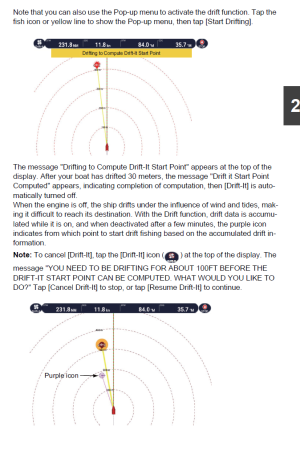

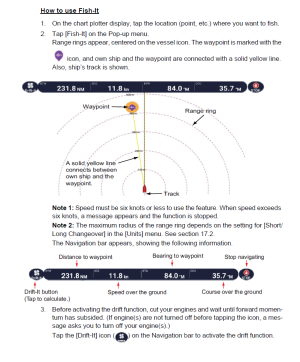

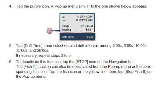

I'm also looking at adding AP since I have electric steering and it seems like an easy integration. Since I have a Yamaha he mentioned the AP will be limited interface, no fish it- drift mode. I believe he has a Yamaha Autopilot kit spec'd maybe not the Furuno one?
Thanks
Thanks
