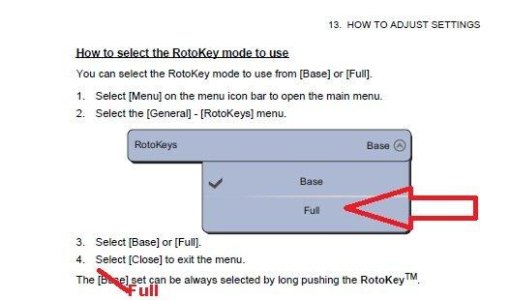

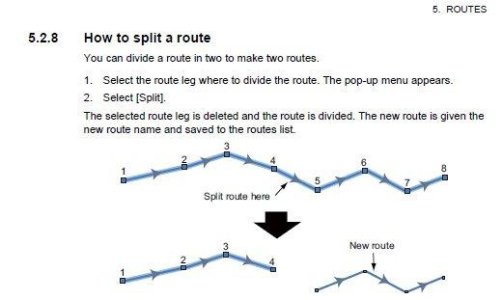

1) I don't see how to split a route
Just make sure you are using the FULL Roto-key option.

1) Once I modified RotoKey to "FULL" the "Split Option" appeared.
