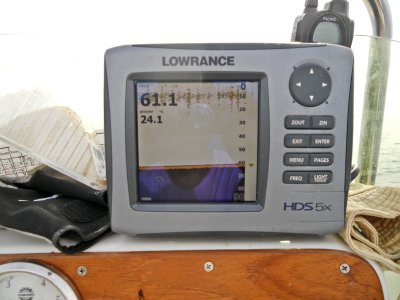

I want to replace my fishfinder (Lowrance HDS 5x Gen1) with a Furuno, and I am very much in doubt (probably I am not the only one) between:
- FCV627: it costs more than the others, even if the product looks more up to date for technology (that’s not a key point for me)
- GP1670 (or 1870): they cost less (I do not need the GPS functions), it seems to me that, as fishfinders, they can give to me the same results as FCV627, and that they have a more simple and functional navigation in the Menu Tree. For almost the same cost, I could choose the 1870 that has a larger screen than the 627.
I mainly go fishing for trolling and jigging, in the Tyrrhenian Sea (Tuscany, Elba Island area), at depths ranging from 3 to 120 meters; my general requirements are:
- I don’t care of functions such as DownVision / SideVision or Bottom Discrimination: I know fairly well the areas where I go fishing and their seabeds
- transducer power of at least 600 watts
- I would use both frequencies simultaneously in two windows of the monitor.
Any comment or suggestion is appreciated, particularly with regard to the choice of the best transducer (to be installed on the transom) for the device.
Thank you.

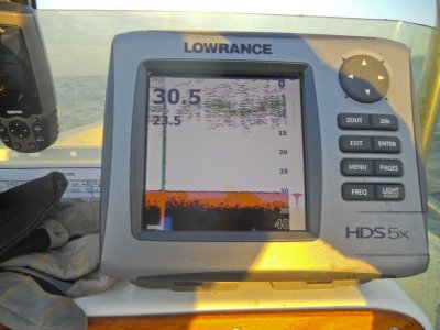

PS: BTW, can someone give me suggestions for the choice of a good filter for electrical interferences I already experiment on my eco
