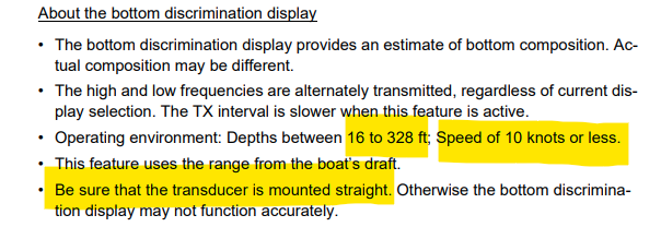

I would ensure that you are not running BD and Accu-fish advanced features both at the same time. It is one or the other, not both. Recommend checking that the correct transducer model has been selected for using the B45 (525T-BSD) and that the transducer face is clean and mounted straight.

Speed was under 10 knots,max depth was 230 ft,B45 is selected but I will check it again.

We mounted the transducer very carefully to be straight at 5,2 knots which is the idle speed of the engine and when we stop it leans 2° front.Left and right is level.
I think that mounting is OK because when jigging,with the fishing lines vertical (no current at all) we could see 30-40 gr metall jigs all the way down to 200 ft...still the same issue,false BDS regardless of speed.
