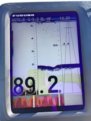

The photos below are from the same spot.

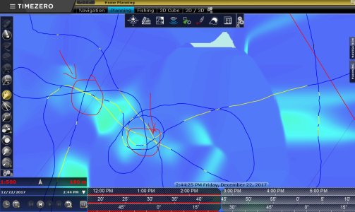

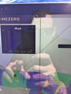

I also noticed that when I pass from the same point but from other direction I get different types of Composition, which they are entirely different. If you see my trails, there are crossings of sand and mud , or Rock with mud.
I dont know if this can be attributed to the TM 265 which is not in the UHD list.

Hard to exactly say what is causing that just by looking at your track line. A couple of items to note when using the Bottom Discrimination mode. The BD mode uses both frequencies, even though you may be only displaying one. It is using the primary along with the secondary seabed returns. It is affected by the vessels speed so using it under 10 knots is recommended. It can be affected by turbulence, your screen shot of the FCV-588 is showing gaps in the seabed using 200Khz so it would be affecting 50Khz even worst. It is affected by the transducers angle i.e. it needs to be pointed straight down. On the Navnet systems it is affected by the draft setting. It can also be affected by what is in the water column. Usable depth range is 5-200m. Hope this info helps.
I Think my TM265 transducer is about 5° angle tilted towards right. I could be that this would cause the Problem, but again, would it show 100% Mud?

Hard to say.
I know when I was conducting some early tests I mounted a transducer on a pole so I could change the angle and I did see a difference.
