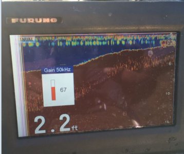

Lagoon Lizard,
Below is a screen shot of the 1870 in shallow water (2.2ft). This system was set up for fishing and not for shallow water detection. He was using a 1kw transducer which is to much power for shallow water. But if you look at the main bang (zero line) and if you were using it on low power I will comfortable that the GP-1870 would show the bottom at 1ft, maybe less. Hope this helps.

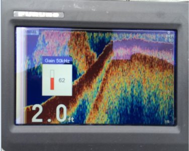

Lagoon Lizard,
Below is another screen shot of the GP-1870 using a lower power and gain setting. The screen shot shows a depth of 2ft but you can see he was a little shallower a short time before.
