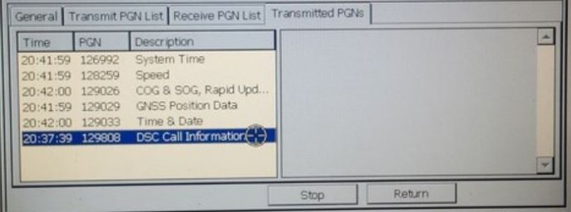

We have a Standard Horizon GX2200 VHF radio with AIS/DSC. It outputs its data over NMEA0183. Since the TZT2 does not have 0183 input capability, I have connected an Actisense NGW-1 0183-2000 converter between the radio and the TZT2.
The NGW-1 shows up on the source list of the TZT2, it is receiving the 0183 data from the radio and putting it on the 2000 bus, but neither the DSC or AIS data show up on the TZT2.
Is there some setting on the TZT2 that I do not have correct to receive AIS and DSC data?
