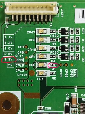

The FURUNO TZT2BB was switched OFF from the switch box without stopping radar transmission. Now the Radar would be powered ON, fans running but no display. Not booting. Only black screen. Am not sure if main board 19P1093-22 IS OK or packed up
Any idea on where to start troubleshooting
