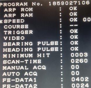

D Dean1345 Member Jun 1, 2022 #3 Is that the test when I go to acquire a target it doesn't let me Attachments 20220601_222226.jpg 896.5 KB · Views: 555
Johnny Electron Administrator Staff member Jun 2, 2022 #4 You have a board. To conduct ARPA on the Vx2 with ARP-11; you must have AD10 heading wired up. NMEA heading will not work for ARPA.

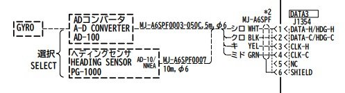

D Dean1345 Member Jun 2, 2022 #5 Thanks for clearing that bit up what do I need to get heading installed I just have a jrc compass
M Magnetron Guest Jun 2, 2022 #6 Dean1345":3dsubxzz said: Thanks for clearing that bit up what do I need to get heading installed I just have a jrc compass Click to expand... On the older style compasses like the JRC JLR-21, they supported AD-10 but double check with your operator's manual. As for the VX2 side of things it connects as follows: Hope this helps, :sail - Maggy

D Dean1345 Member Jun 7, 2022 #7 I am getting heading on radar screen but when I do test it isn't coming up just blank
Johnny Electron Administrator Staff member Jun 7, 2022 #8 Most likely because it is in NMEA format not AD10 format.
