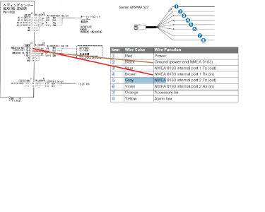

Can I connect the Furuno PG 1000 with the Garmin GPSMP 527 :
Furuno TD-A -> Garmin NMEA 0813 internal port 1 Rx (in)
Furuno TD-B -> Garmin NMEA 0813 Ground
see picture :
Connection without a proper level converter will work about 90% of the time until the 10% when it doesn't work at the worst time. Hopefully it holds up for you.
