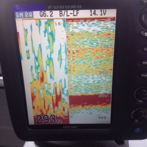

IMG_706.jpg Could someone give me some set points for fishing 250'~350'. Haven't had much luck trying to look for bottom fish. Tried setting FF to look at the bottom 20' and this is what I get.
Nunya,
Would it possible to post a larger screen shot? This one is to small is see any details.
Nunya,
Thank you for the larger screen shot. So I have some questions for you, what is the transducer are you using? What is the TX Rate, vessels speed and screen advance when this was taken. Also do you have a screen shot showing both frequencies?
Transponder TM260
TX Rate 10
Vessel speed 5 knots
Screen Ad 1/1

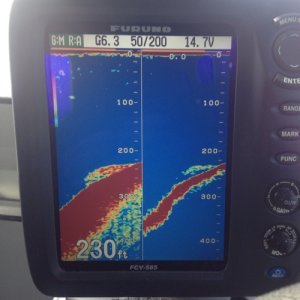

Nunya,
Thank you for the settings.
This last screen shot looks pretty nice to me as it is showing some sort of target close to the bottom. Were you in a different area than before? Just know that any sounder is going to have a hard time seeing targets through that much stuff in the water column.
In that second screen shot the only setting change I might try would be going to a MAX TX Rate to see the difference.
