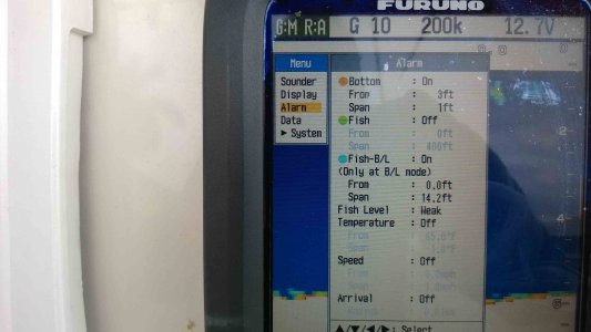

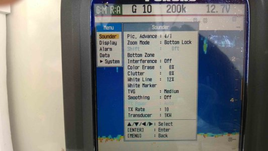

I have a FCV 585 Sounder attached to an airmar M260 1KW in hull transducer. The sounder was returned to the factory last year and firmware updated and checked out. I have never had a good response from fish in the ocean. It seldom ever shows fish symbol at any depth. I have spent some time floating over some shipwrecks here in florida and cannot get much return from fish . I have sent some pictures of the setup with unit in manual gain. I have tried fish setting as well
