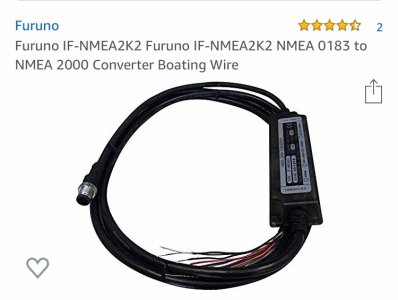

i have an SC-30 installed along with an FCV 1150, i have done all the settings to have the Heaving compensation work but i still have no Heaving compensation Icon on the top right corner of my screen. Can you kindly let me know or send me a picture of the correct settings to be done on the FCV 1150 in the Heaving settings along with a snapshot of the NMEA settings page picture to check if i have things done correctly. One final Note, i have the FCV connected to a R509LH transducer, does it affect the Heaving option or should work?

Good morning KGB666,
So how is the SC30 connected to the FCV1150, we need wire colors and also what converter is being used and what location and pins on the FCV1150?
C-Bass
Sorry it is a SC 33 and not 30, it is connected through a universal converter, will and should it work? Or I need the original Furuno Converter?
What converter is it? Make and model? What wires are you using? Please provide as much detail as you can.
i am connecting this unit to the FCV 1150, can you be kind enough to send me where to connect all the cables as the diagram you sent me only shows that i have to connect 2 wires.
Is there any video link or step by step in depth setting for the fcv 1150 as the manual does not dwell deep into the true settings for deep see settings?
