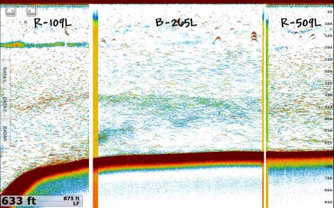

Tough call for me. I think it comes down how much time you will be spending in 20-150m range. To my knowledge both transducers use the same wide element for HF side. So the main difference (besides mounting style) would be the LF side. The arrangement of the LF elements gives the 275 a conical pattern but the elements in the 109 are in rows so it has an elliptical pattern. So its wider side to side than for/aft. Below is a screen shot where I compared the LF side during one of my tests. Note that the B-265 and the B-275 use the same LF arrangement. The big thing here is to note how the beam width of the transducer affects the target returns i.e the wider the BW the more arched the returns. I also found the LF side of the 275 likes 42Khz and the 109 likes the 36-38Khz range. Of the two the 109 will give you better results in deep water. Hope this helps.

A little more about that last screen shot I posted. That was done early on when I first starting test our UHD (Chirp) module. Basically I wanted to see how different transducers affected its performance. I didn't change any of the sounder settings just tried different transducers. Also the UHD is 1kw so all the difference in the target returns is strictly transducer related. The bigger transducers have a narrowly beam width and more elements so your target returns come back shorter but harder. Now I did a little different test using an FCV-1150 a couple years later. In this test I more interested in finding the frequency sweet spot of the transducer rather than comparing beam widths. But it should give you idea of what scattered fish targets will look like. One thing to note in the below screen shot is while the targets appear to be at the same strength the gain for the 509 is 1.5 vs. the 265 at 4.8.
While the CA82B-35R is a good transducer it is not popular in the US.

I can't say I have never had or seen noise issues but they have never been directly related to having a "Chirp" transducer. I have water flow issues and I have seen electrical interference but I seen those types of problems with non-Chirp transducers also. If you are spending 95% of your time in 200m or less you really can't go wrong pairing the 295 with either transducer. Remember the only difference will be the beam width on the LF side.

There are three components in the depth performance. Power, beam width and frequency. Of those three, most think power is the main factor in going deeper but in fact it is the least important. Of the three, frequency is the most important followed by the transducers beam width and then power.
Simply put it all starts with the transducer and its location. Overall the R-109LHW is a better for deeper waters so it comes back to how much time will you spend in water deeper than 200m?
The LH side of the R-109LHW is a better (but narrower) than the B-275. If you can fit it and it works with your budget, that's the way I would go.

I think I posted two pretty good screen shots earlier. You will need to decide how you want your LF targets to appear. The HF side appear the same.
