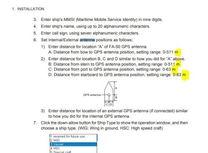

I tried doing as the OP suggested and didn't get the same result. New FA50 (purchased 2020) was already set up for "internal" antenna and there was no option for adding boat length. What I DID discover is the FA50 generates your boat length based on the information you add for antenna position. Basically it adds up the numbers. So if you enter that your antenna is 6 meters from the bow and 8 meters from the stern, your length will broadcast as 14 meters. Same logic for beam. The correct information is now showing up on all the AIS tracking sites. NOW....does anyone know how I can change the units for antenna location from meters to feet?

The unit HTML firmware is setup for meters as a measurement of antenna placement. It isn't something that should be changing often unless you are moving it from boat to boat. Feet is not an option for this setup.Capture9548.JPG
