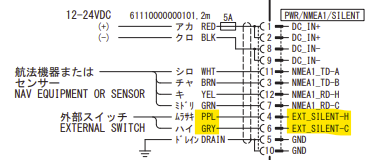

J JohnTFT New member Apr 13, 2025 #1 Can you silence FA-70 transmissions from a TZT12F? If the silent switch is the only way to do this - a single pole toggle switch to what color wires will make that happen?
